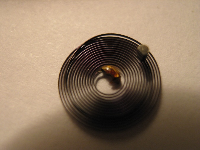

So, not only were both pivots bent, but take a look at the picture below
February 21, 2012, 20:45
Jon HartI am no watch expert, but I have never seen a hairspring that was held to a balance staff via shelac.
Note the missing portion of the collet and the "puddle" of shelac on top of the remaining collet
February 21, 2012, 20:48

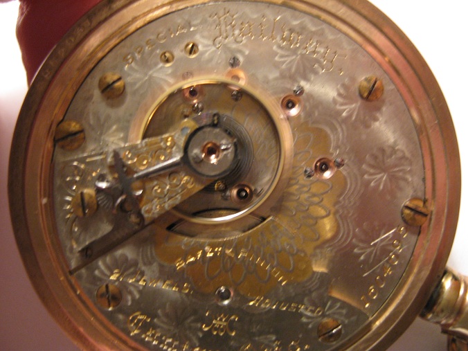

Jon HartWith a new balance staff and a replacement hairspring - Gene saved another watch...
Good Job - Gene!
