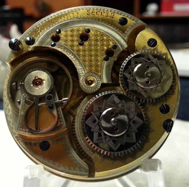

1890 Rockford Model 1 Grade 101 (my latest shiny object)
Anybody got a case? Recommendations on a case? Looks like she will live in a salesman shipping can for awhile...
Grade: 101
Movement Serial Number:360012
Estimated Production Year: 1890
Run Quantity: 500
Jewels: 15j
Movement Configuration: Hunting
Movement Finish: Nickel
Model: 1
Movement Setting: Lever
Plate: 3/4 Plate
Adjusted: Yes

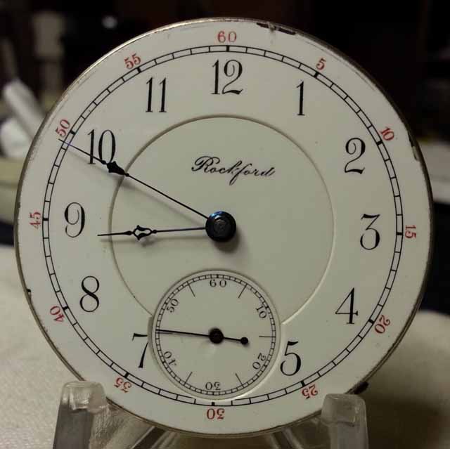

Dial

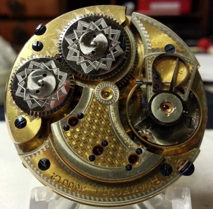

Another angle

I was tempted to bid on that one too, Paul, but the dimples around the upper balance jewel scared me off.
I've never seen one of these cased, so I also didn't know if it would fit into a standard-sized 16s hunter case.

Eric,
Thank you for pointing out the upper jewel... I was so caught up in how cool the gear train layout looks and the overall corrosion free condition that I did not even notice the peening on the cap jewel.
That means I will be looking for a donor before I attempt a COA... will display the watch for awhile to wait for my skill level to catch up to the task... and since my new "most favoritist" thing in the world is balance staff pivots, wait for a day when I'm feeling especially spiritual before I attempt to go in to the balance assembly.
