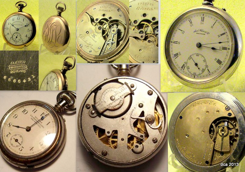

Some of the US-Made Pinsets that passed through my collection are (from Top left clockwise)
1. 12s Hampden Deuber grand
2. Waltham 14s Bond St.
3. Ingersoll Bros ~ 16s
December 02, 2013, 21:12

The mechanics for the Hampden pinset was crude at best, I agree with Harry that because of the market itself and the need for a special case, Hampden pinset production had to be very small.
