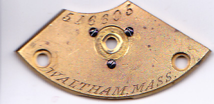

The first is about the picture attached.
What are the three screws around the mainspring arbor for?
Keep in mind I am a virtual novice.
January 30, 2014, 20:50
Peter Kaszubski

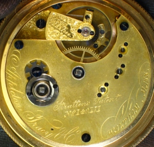

Melvin look at my picture you will know what the
screws are for.
January 30, 2014, 22:13
Melvin Siedman
Oh A collar to guide the winding key.
Missing on mine.
First Problem, but I am sure not the last.

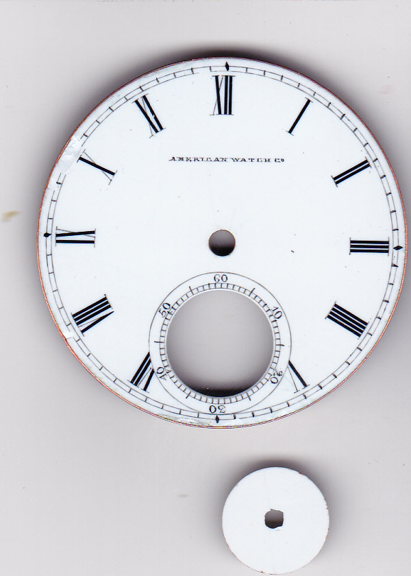

Also the dial has no marking on the sub seconds area, but does have seconds markings on the dial around the seconds area. Is this correct.

The solid balance wheel most likely pre-dates the split balance. Making this a very early example of US watch making.
Can't really speak to the dial without a photo.

Here is the dial.
It fell apart when I went to clean it.
PS , how do I put it back together?
Mel
January 31, 2014, 12:51
Paul D. Trombley
The early dials were put together with something Dave Abbe refers to as "buffalo glue"
I don't soak my dials. I hand rub them in a dilute solution of dishwashing detergent and nothing more aggressive than my thumb print for the main surface and a make up brush for the corners, usually less than one minute. If it takes more than that, I use a "make up applicator" and work on a spot or a hairline with what ever is indicated for the particular type of stain. Teeth whitening gel for nicotine or tar stains, goof off for glue, CLR for water damage or rust...
These dials pre-date solder... so, you can glue it back in from the back side with what ever works. Enough to make it stick, but careful to minimize the amount of clean up that needs to be done on the stuff that squeezes out the front. If the glue "stands proud" on the back side after it has dried, I find I have to trim it down or shave it down so it does not interfere with the dial laying flat on the pillar plate.
Gorilla glue works for me... but others may have recommendations.
January 31, 2014, 14:43
Many of the early glues were renderings from Horse's foot-bones and toenails, etc. That type adhesive cannot survive a "modern" cleaning. With a long past experience of applying tiny amounts of low viscosity CYA (Superglue), I actually use that very sparingly to reassemble these. You first pre-position the seconds chapter with a bit of Rodico, then put the dial with insert FLAT and face-down on a thin poly (sandwich bag) film or waxed paper and then using a round pointed end toothpick, apply microdrops of CYA to the backside seam between the seconds chapter and the main dial. The thin CYA should "wick" into the dial/insert seam without messing up the dial face. Let it set five minutes before touching it.
January 31, 2014, 15:38
Samie L. Smith
A trick i was shown several years ago works good ,use just a small bit of super glue too fix the postion of the seconds bit,,then use flake shellac broke in small pieces and placed all around where the 2 pieces join ,,Then with a solder iron held close too the shellac it will melt right in and hold the 2 pieces together just fine.
A lot of the very early Howard watch dials where put together with Shellac.
January 31, 2014, 22:09
Melvin Siedman
Hi Dave and Samie,
I decided to try the shellac first.
I put 3 dots of shellac around the subseconds ares.
The shellac melted but did not **** into the crack.
Should I try to clean the area better, or try another approach.
