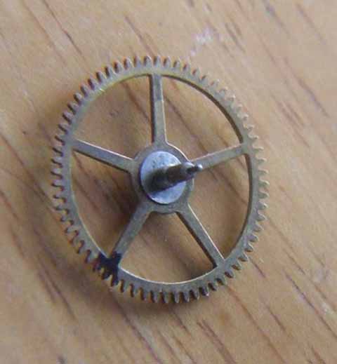

I have started the process to restore the Seth Thomas PW I have. The pivot on the center wheel on the plate side was broken off in the cannon. Now i understand what Lindel said that Staking Set are best asset one could have.I want to know how to remove the rest of the staff with out damaging the wheel.

Center Wheel

It might be wiser to look for a new center wheel. There is a lot of force on this wheel. It would be hard to get this wheel re attached to a different center wheel staff. Please post a picture of the plates so others and my self can see if we have a replacement.

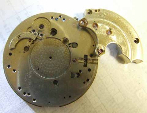

plates

David Abbe said this was 1 0f 1000 made, center wheel train plate is jeweled. I purchased a jewel guage pin set to be able to tell the size, but they will not be here for 10 more days.

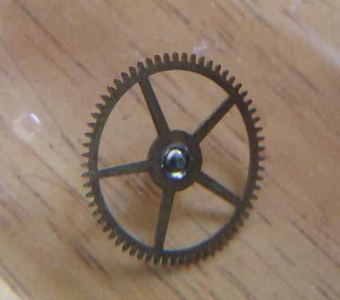

other side of the wheel

Can you measure across the movement. I have over 100 small watch movements. Elgins Seths,Walthams. I'm trying to narrow what parts movement you need. I have one that is 33.9 mm

Francis, I have both types of center wheels (jewelled and unjewelled), but your pillar plate is bushed, whereas your upper train plate on that Model 2 is jewelled - making an odd center wheel indeed.
Are you sure the serial numbers match? Seth didn't make an 18-size watch with an even number of jewels.

@ Eugene it is a size 18's model 2. @Eric all serials match on all plates. David Abbe said the same thing that since there is was only 1000 made of this model finding another wheel may be a bit hard.That is why i asked if the staff could be removed, as there is a micro Engineers in sydney whom may be able to make the staff. Two tools i do not have but are on there way is digital micros, and jewel guages.....Eric serial number on all plates "87941"

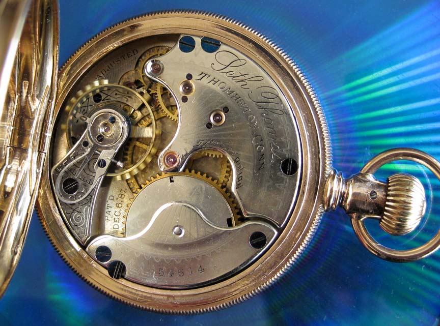

Harold Visser
Here's my 16J Mdl.2 Seth, center jewel is a bit different, it's a friction set.
