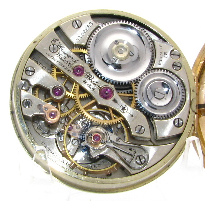

Here we go, can anyone identify this Howard? is it a series 1 or Series 10, being unmarked if so why? Confused
The number is lower than most found for Series 1 and being unmarked could it be a No 1 model? can anyone show a No 1 model to compare to? Smile

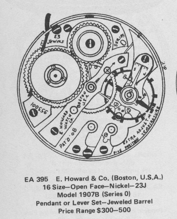

Could this be a series "0" down-jeweled to 21? The fitments for the barrel jewels are there and look to be finished without jeweling.

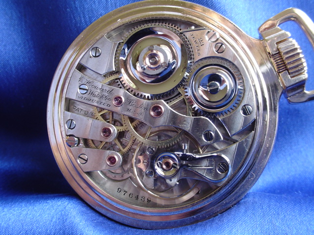

here is a unmarked 23J that I once owned
www.Abellwatchmakers.com

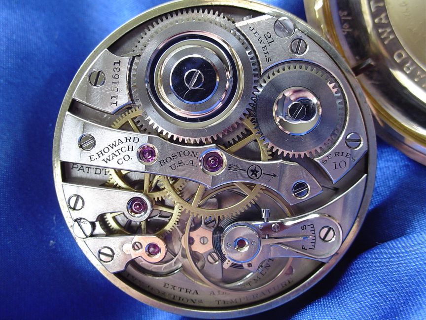

here is a series 10

Could a No 1 (shugart P 264) being scarce be a down jeweled 23? as they came after 23J series O and preceeded Series 1 I have never seen a watch or photo of a No 1
Click here for a series 1 same barrelSeries 1 barrel cap
No 10 not series 10

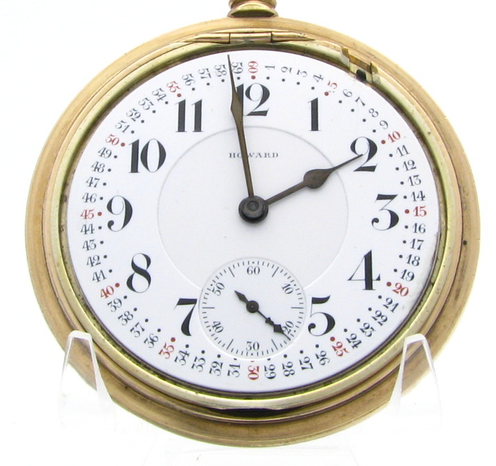

Nice watch Chris, don't have an answer for you but I LOVE THE DIAL on this one.
Ray
August 10, 2008, 18:19
Chris Abell
Hi Ray,
This is one of my favorite Howard dials
