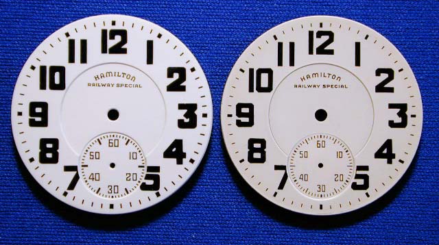

Welcome Aboard Clyde,
When Hamilton introduced the 992B in 1940 and the 950B a year later they had beautiful porcelain dials. After World War II as a cost cutting measure, melamine surfaced dials were phased in. Today nearly 60 years later we hold them in low esteem, but they actually held up well for many years. Problem is time has not been kind to them and nice ones are becoming scarce so I would recommend against using a nice melamine dial in daily use.
Click this ""Find-Or-Search" for "Melamine Dials" lots to wade through but it may be of interest.
As Peter pointed out with melamine the surface becomes degraded over time and begins to crack. Add to that the signature and numerals were only painted on the surface, so if that surface is polished it removes some of the paint and being soft they also scratch easily. I'll drop in an image below this post that will show you why Samie likes the earlier 992B examples with their beautiful porcelain-enamel dials. Cool
Porcelain-enamel on the left and Melamine on the right...

Thanks for the images. I've been reading the various posts about melamine and the problems associated with its aging. I'm having a ball puttering around the archived posts and learning a lot that is new to me. The 992B board is a wealth of information about these watches, too. The 992B is my new project, and my old 992 is awfully lonely and in need of a later "friend." Smile
