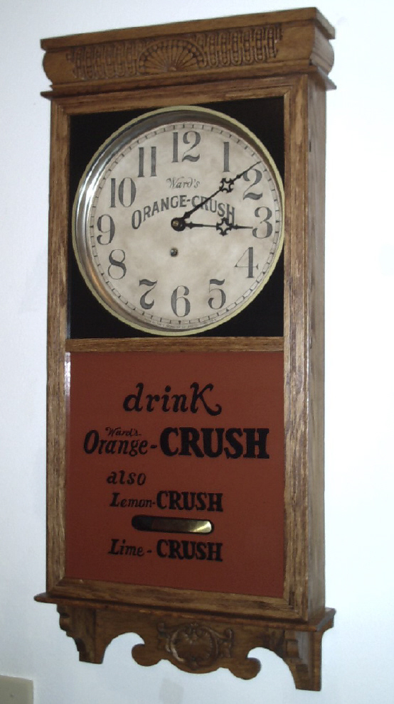

Thought I would share a project case I bought off ebay a few weeks ago,restored with an original Ingraham movement.As most of us I forgot to take my own before pics but I was able to get the ebay ones,here are the links to the before photos:

March 12, 2005, 19:24
Derek B. Phelps
Kent,
Great looking store advertising clock. Its terrific to see a clock brought back to its original glory. I love the lower advertising tablet.

March 13, 2005, 09:42
Kevin Pestor
Hi Kent, nice job on the clock.I did not realize orange crush was that old of a soft drink.
Sure is a nice one to put up on the wall.

March 13, 2005, 16:40
Greg Reeves
How cool is that! Were the glass and dial with the original clock or from another?

March 13, 2005, 23:21
Kent Watson
