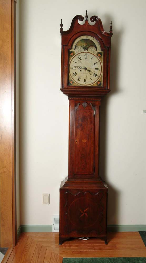

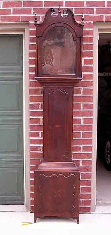

Douglas Barr
Case

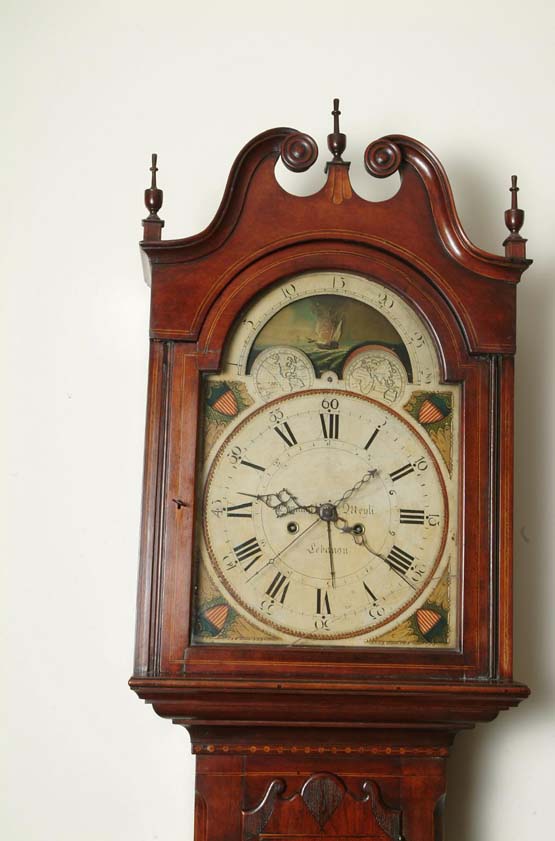

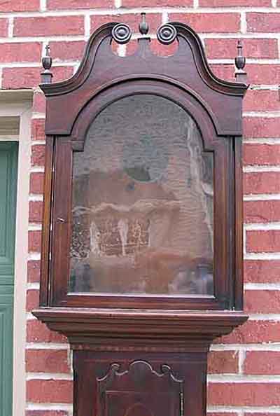

Douglas Barr
top

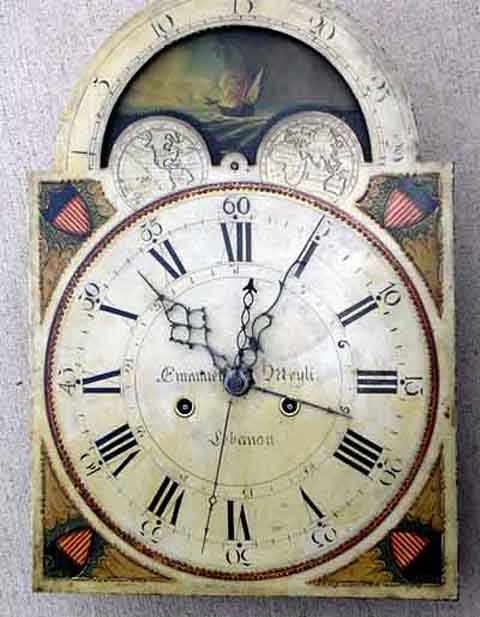

Douglas Barr
dial

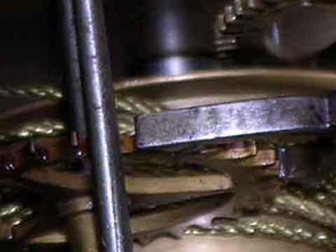

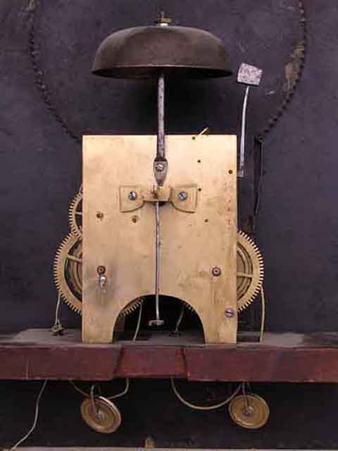

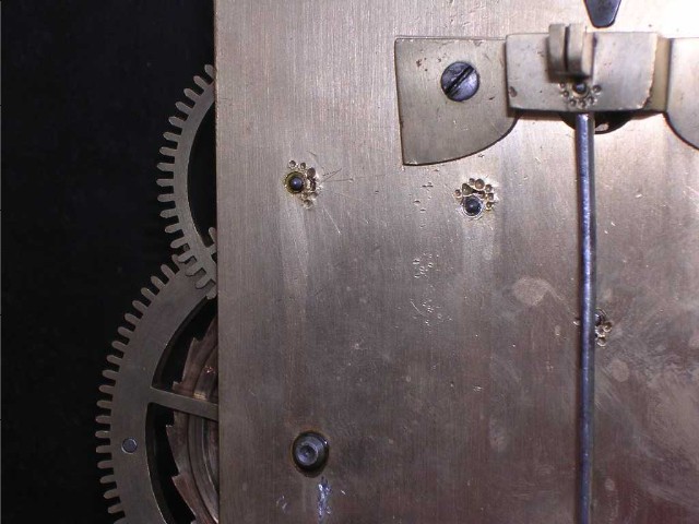

Douglas Barr
movement note punch marks on plates

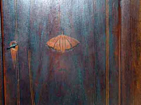

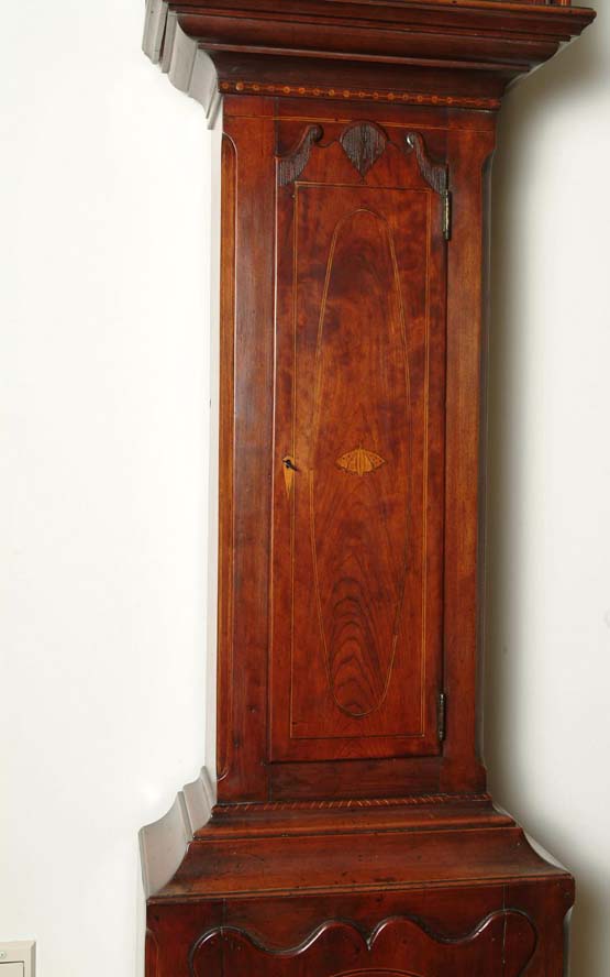

Douglas Barr
Note butterfly inlay does anyone know the meaning of this?

June 29, 2004, 23:33

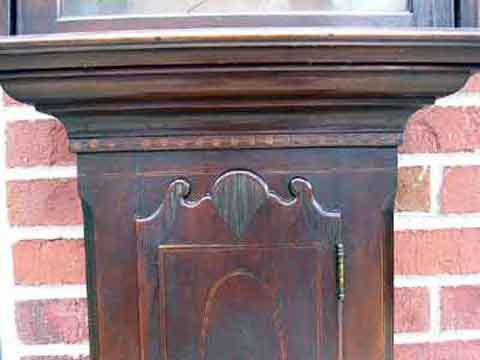

Douglas Barr
Note the carving on the door>Very unusual

Jim Cope
...fun story and a fine clock Doug!...will look forward to seeing more photos as the restoration continues...should be an accurate timekeeper with the 'deadbeat' escapement...btw: butterfly looks more like a moth to me; don't know the significance of it but likely the casemaker's TM...

Douglas Barr
Movement is done. Mike Paul of Akron Ohio has done the movement and has usual excellent job. Mike had to put 7 bushings in the movement.He also commented the movement is American.Smooth winding drums and a half moon cut out on the back plate.Wonderful movement. Case will be back in Sept. (Mike has won 16 craftawards including 4 gold medals.Has also made his own movements from scratch)
August 01, 2004, 21:44
Tom Seymour
Great picture Doug! The work of earlier mechanics (pre bushings) is evident. A great clock!

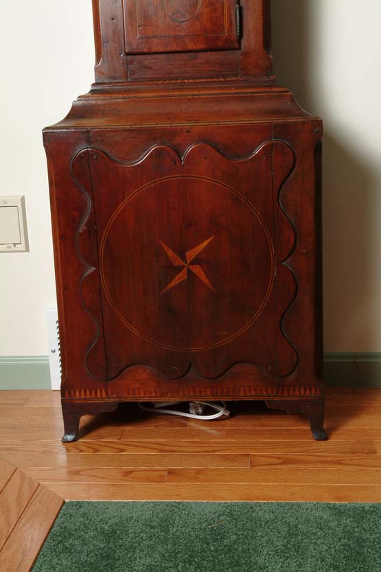

Douglas Barr
case
January 14, 2005, 00:03
Douglas Barr
case
January 14, 2005, 00:06
Douglas Barr
hood
