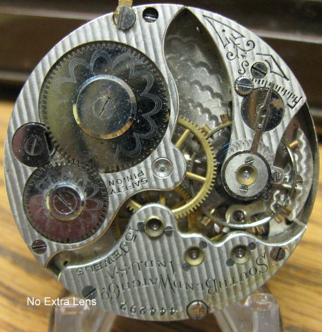

Here is a photo with just the camera lens set on Macro. All photos were take holding the camera with my hands so some blur could happen from movement.

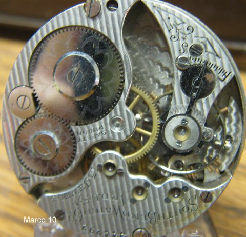

Here is a photo with Macro 10+ lens

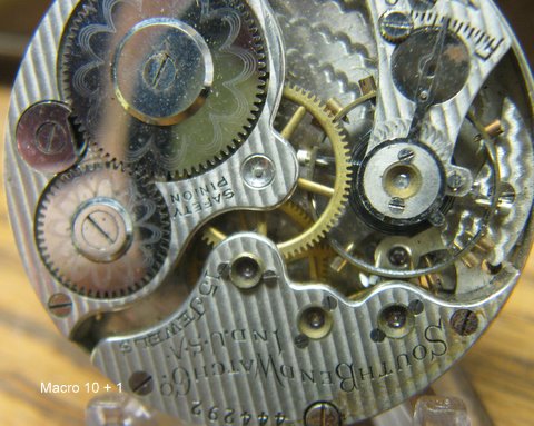

Here is a photo with Macro 10+1+ lens

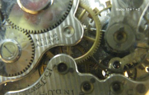

Here is a photo with Macro 10+1+2+ lens

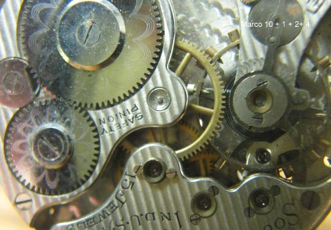

Here is photo with Macro 10+1+2+4 lens

The 10+1+2+4 is closer than I can get now. I would like to get a little closer, but for the price that will be good enough.
Thanks for taking the time to show us.

I think if one purchases two 10+ lens kits and add them together you will get real close. but you will need to use a stand for the camera as you cannot hold the camera still enough with your hands.
You will also need a light box or some form of indirect lighting. I used indirect lighting when I took the pictures above. Otherwise the adaptor tube shadows the item you are photographing and you get the shadow.

Can you shoot the same picture as in your first example with no lens and just macro mode in the highest resolution you have and the just crop the image using your photo editing software on your computer and get the same results? Just wondering as that is usually what I do.

I tried it before I bought the Macro Lens kit. When I enlarged it, even with high resolution, it still got fuzzy. I get better results by far with the lens kit.
Here the first photo without the extra lens. I enhanced it with my photo program. Actually I was surprised at how well it came out.
