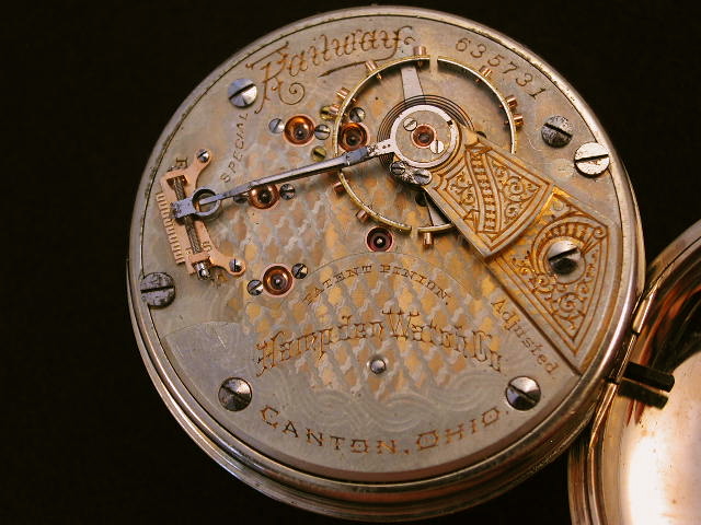

One of my latest acquisitions. Because of the pressed centre jewel, the lack of gilded screws and the way the word "SPECIAL" is oriented I have a suspicion that it is a 15 jewel Railway up-jewelled to 17. What say you?
April 02, 2012, 17:38
Lorne Wasylishen
Mvt. S/N 635731

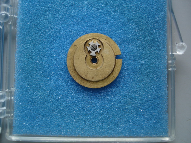

And I guess while I am at it I should ask about a part I need. This is not the part I need and this is not even from this watch but it looks like this.
I need the little part that goes on top of this part. Not the right term but my watch guy called it a "spring limiter". It goes in the motor barrel and keeps you from, he used the term "overwinding" but he also said it is not overwinding. The watch runs very well without it but I was cautioned to only wind it about 15 turns until I get this part.
Clear as mud I know but hopefully someone will know what it is that I need.

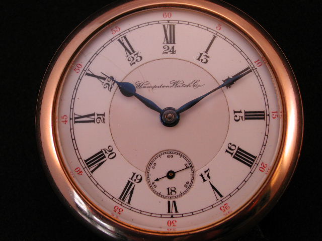

Lorne you have a very nice Hampden and a relatively rare watch. The dial is an excellent example of Hampdens double sunk 24 hour or Canadian dial and is scarce in that condition. They are more commonly found as single sunk dials. I believe you are looking for the stop works part and Hampdens with that feature are not often found. Based on the serial number, the damasceening, the lettering, and the stop works design I believe you have a 15 jewel Railway movement up jeweled to 17 jewels. I will check to see what I have for parts but am not optimistic that I have what you need but will let you know. As a certified Hampden nut I would love to own your beautiful watch if you ever want to part with it. Congratulations on a fine and most interesting watch.

Hi Lorne,You have a really nice Hampden there!I'm turning green looking at it.As Deacon said, it does look up-jeweled for sure,if it was built with 17 jewels,it would be marked.Whoever did the work did a nice job, looks like a gold setting in the center.I wonder if that could have been a factory job.You did good!Best regards, Ted.

Deacon, thank you for the information confirming an up-jewelled Railway. The dial looks even a bit better than the pic since I cleaned it but at some point in it's life something was dropped on it and there is a spider emanating from the m.
It looks a bit "heavy handed" for this dial but I have seen what I believe to be the same hands on other Hampdens. I had considered the butterfly hands seen on some early watches but am quite happy with this one as it came to me.

Ted, thanks, you slipped in there without me noticing. This watch has a bit darker hour chapter. I have seen this in a few other non Hampden watches of this era. I assume the sunken portions were cut from different porcelain batches, is the colour variation due to manufacturing inconsistency of the time?
Could this be (Joking) the rare and highly prized Tu-Tone dial?

Hi Lorne, could be that the center area of the dial being thinner may just look a little different because of the thickness.Do you see many Hampdens up there in Canada? Take care, Ted.

Hi Lorne, As a child I lived in Springfield Mass. (Hampden County) and fairly near the Armory. At that time in the early 1950's Springfield had a substantial number of skilled craftsmen, tool and die makers etc. and I would listen to what they did and it seemed "awesome". At age 8 I inherited an 18s watch and took it apart to my mothers dismay and expense for putting it back together. Then moving to Omaha where the railroads were and hitting the hock shops for pocket watches somehow set me on Hampdens. They were fairly well represented in this part of the country and have always been cheaper and somewhat disparaged when in fact they made some excellent watches. It is fair to say that the 15j Railway was a strong competitor to the big boys and the 17 j Special Railway was also. John Dueber was a hard boiled old German but an excellent case maker and great competitor known for conservatism and honesty. I am looking in my parts pile for your stop works piece which is quite unusual on Hampdens and I believe only found on a limited range of serial numbers around the time yours was made. Incidentally that time period is when they were going to the 17j upgrade and I would be guessing but do not think more than a few hundred were made such as yours and probably not more than 100. I look for unusual Hampdens and have never seen one exactly like yours. The hands are not original but look fine. Your watch is probably as rare as a Hampden Ball and yet not that pricey. Ah, the vagaries of the collectors life!!!!
